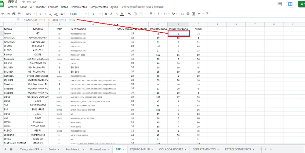

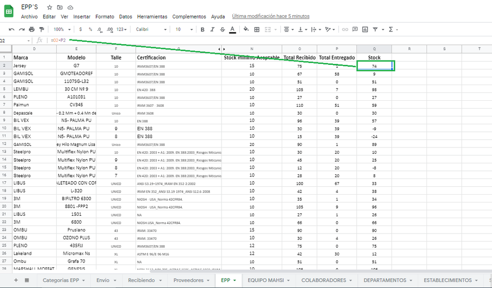

Sure, the stock quantity is calculated with a spreadsheet formula that subtracts the received - delivered column. In turn, these two columns receive their data from another formula that looks for the data in the delivered table and the received table.
EPP table where you receive the information on deliveries and departures and perform the stock count
Shipping and receiving table
I would not except Automation to trigger appropriately on data being changed by spreadsheet formulas.
I’d suggest you convert your calculations to all work in-app.
