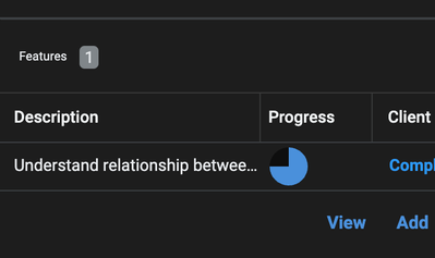

First, there is a Progress column (see below) that will show a pie chart image to indicate the progress.   You will need to create an expression to determine the progress level and set the proper Enum value.
Second, there is a percent column.  Same idea applies where you would need to use an expression to decide what percent level you want to set
You could combine the two and show both a percent level and the visual progress chart.
Column definition of Progress
Example of how Progress column is displayed

FIrst, I don't recommend performing any computations in the sheet directly, unless you absolutely have to.
Yes, you can automate it in AppSheet - as long as you know what the formula should be to determine the percentage level.   Then you just apply that as an App Formula in a normal column or a Virtual Column.
Use a normal column as the Progress column if all the values to compute the progress level are in the same data row.
Use a Virtual Column, type = Progress, if the formula relies on values from different tables.
Do you know how to compute the [Current Load] as a percentage?  I'll assume [Capacity Left] = 100% - [Current Load].
