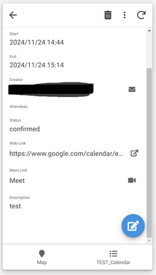

See below for my test event in Google Calendar.

My test Calendar event as viewed from Google.  The Description was added when the row was added,  Then updated with UPPERCASE text.  Both originated from form saves in AppSheet.
