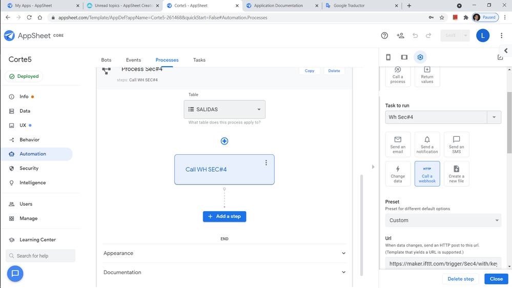

Previously I had already worked with WebHooks when they were made in “WorkFlow”, the ones I did still work fine, however I want to make new ones and they do not work … to avoid my mistakes I made one with data copied in “task” of one that did it works in “workflow” but in “Automation” it doesn’t work … the screens of the data that I put in the processes and events …
As the app shows error and cannot be used, I have removed everything from the app to use it …
this is the textual error
“Unable to fetch app definition. Error: Data table ‘Process Sec4 Process Table’ is not accessible due to an internal error. Please contact support@appsheet.com.”
Also send this letter by mail to the indicated address …
Please help…
here the error screen …
here what I copied verbatim with the “COPY” option of a “TASK” that does work well in the workflow
here the “proceses” that marks the source of the error …

Try to see what happens if you remove the # from the process name ?
I think that will fix it.
Will check why it is getting truncated for a long term fix.
Thank you, that was it, remove “#” from all sides and it no longer generates the error, Thank you …
The fix for this is being rolled out. You should be able to have # characters in process names within the next hour.
