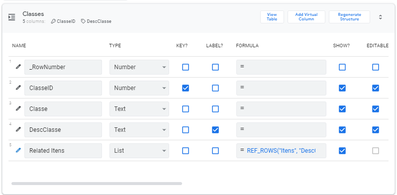

But i have a Third table named Classes. I use this to criate diferent categories for my itens stock. Following the instructions manual, i made a ref column named [Classe] on Itens Table calling a [Classe] Column in the Classes table like you can see below:
[image|not allowed
[image|not allowed
Like you can see, in Classes Table Iโ€™ve criated a column to tip the description of each class, and other to tip theirs initials . Itโ€™s is just because i concept the app design like this way.

I want the values from the drop list appear referenced by their complete name and not by the initials. BUT i wish data on itens table has being registered by inicials and not by complete classe name. How do i do this?
Solution of my own question understood while i ask it:
Is because this question we use labels. The solucion to this problem is just set the Column [DescClasse] as the label of the table.
Thank all for read the question that i solve by myself
