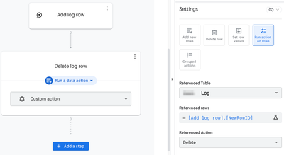

Hi @MultiTech
@MultiTech wrote:
and then the last step of the automation DELETE the log record...
How is this implemented. I have added a new row to the log table when a BOT starts. Then when the BOT ends how can i delete the same row, more specifically how can i get the key of the row created in the earlier step.

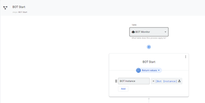

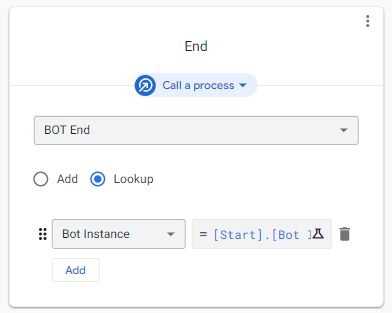

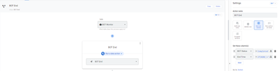

@dbaum Thank you so much ๐Ÿค— I have implemented it. This Call a process and return values were something that was over my head until your explanation. Thanks once again.
@dbaum I made a small modification. Instead of deleting the row, I made a BOT Status column which is set to Started at first step of BOT and set to Completed at last step of BOT. If the Status is not Completed after 5 minutes of Start, then Status is changed to Error with help of another BOT. I am explaining below the way i implemented it in case someone finds it useful. Please share your thoughts/comments on this @dbaum @1minManager @WillowMobileSys @Aurelien @SkrOYC
STEP 1 ---> Created a BOT MONITOR Table with the Columns below
STEP 2 ---> Created a Process, BOT Start under BOT MONITOR Table

STEP 3 ---> Created a Process, BOT End under BOT MONITOR Table โ€ƒ

STEP 4 ---> Added FIrst Step in all the BOTs to be monitored as START
STEP 5 ---> Added Last Step in all the BOTs to be monitored as END
