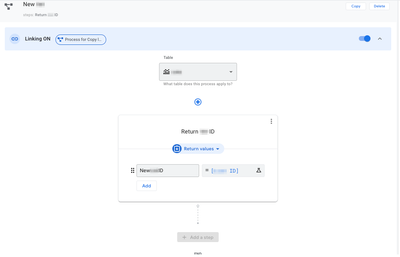

Return values step (in child process)
It's a little counterintuitive in term of the automation authoring process, but you first need to create the process containing the "Return values" step so that it's available to select in the "Call a process" step that will ultimately precede it in the automation workflow.
Create a process for the table where the row will be created; ensure the process has linking enabled. The process can include just a single step--i.e., "Return values". For each value that you include to return, the name you assign can be referenced in the parent process's subsequent steps.
