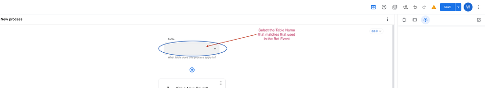

This usually occurs because the Process was added without a Table specified.  You need to go to the SAVED process and update it to the Table that matches the Event.
To get to the list of Processes, hver over the Bots icon in the left-hand side Menu.  Then tap on Processes.
Find the Process int he list and open it.  At the top is the Table field.  Update or adjust it to the Table name used in the Bot Event section.
I hope this helps!!
