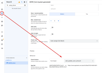

- call this action on the event form of the new entry:
9 REPLIES 9

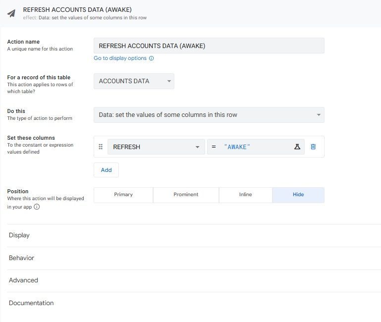

Hi Aurelien,
I initially had a reset action, but then I noticed that extra lines were getting added, it was like it was interfering/and causing duplicates, it was very confusing so I disabled the automation.
This evening after reading your suggestion I tried it again, and it seems to be working as expected. This is what I did in below screenshot...
I have a few actions for sending statements etc that I notice sometimes work when you trigger the action button inline in detail view and sometimes dont, is that the norm that if you dont have almost like a "reset to initial value" for an action then it cant repeat itself? (Although they normally seem to eventually reset somewhere down the line perhaps through a few updates in the referenced rows etc. would be good to have some finer detail instructions on how actions reset etc)
But also I noticed what also worked is instead of two actions, one action which set value of column [REFRESH] to "AWAKE", and in the same action set the value of column [REFRESH] to "GO BAACK TO SLEEP" then only having one process in the Bot vs two procecess...do you forsee any problems in either, both seem to initially be giving the same expected result?
vs One action and one process;
PS @Aurelien thanks for applying yourself to my challenge, was very helpful!!

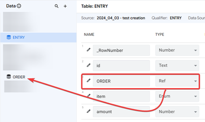

These two assume you have, for example, a table ORDER and a table ENTRY.
And that the table ENTRY has a column named "ORDER" that refers to the table ORDER.

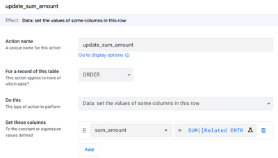

2) use of real columns:
- create an action "update_sum_amount" in your parent table, and set the expression you need (I think you already have it). It could be:
SUM([Related ENTRYs][amount])
@Aurelien thank again, that did the trick, I had an existing virtual column that I used, and an existing action just needed to add that final execute an action on set of rows, and change the form view event action.
Thank you!!!!!!!
