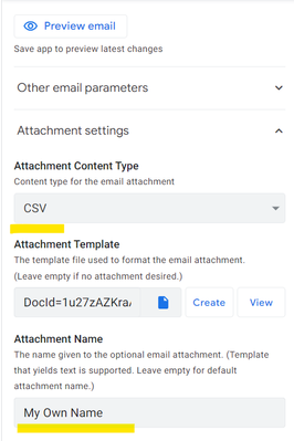

Hi There, I believe if you use a Bot with an action, then you can use the settings on the side to assign a prefix to your CSV file and this can be dynamic as well ๐Ÿ™‚
