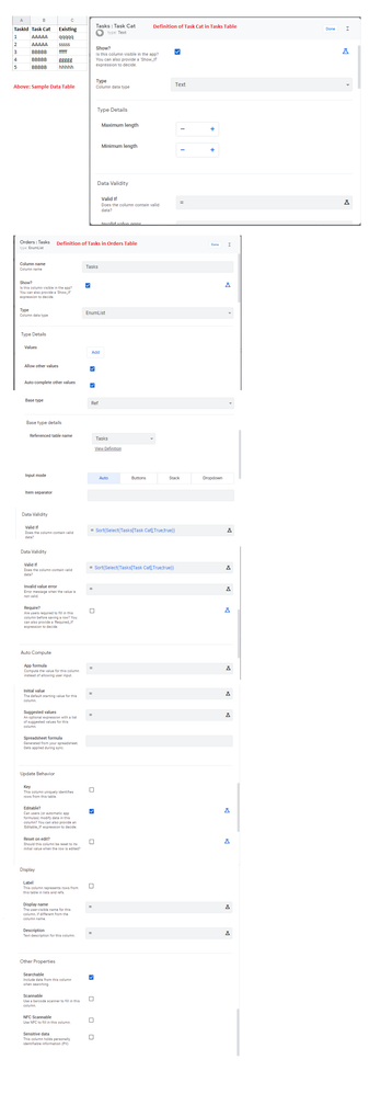

I have created an image that contains a collection of what I currently have in place.
  1. My Tasks table looks like the top left of the image. There are more columns but two are enough for the purpose of getting this working
  2. The Key field is a Text Field called TaskId with a default value of UniqueId(), not shown in the image
3 The task table has a field called Task Cat which is a Text field that may have multiple repeats. This is shown at the top of the Imae
  1. The table has another field called Existing shown in image.
5 In the Orders table I have an Enumlist field called Tasks that is a REF field referenced to the Tasks table. The ValidIf condition is intended to ensure duplicate value Task Cats are not displayed. The intention is for users to choose which Task Cats are applicable to the entry.
I then have a WorkFlow that sends an email based on a template that looks like the one below. I need it to show all the Task Cats and associated Existings
I have been trying to test it this weekend but ran inother problem that has now been referred to support. At this stage the EnumList selections works but the EnumList entry form has yellow triangles. My Select statement is not yet working either. I would like to persevere but Iโ€™d like to get past the triangle problem and get the Select working. Any suggestions welcome
