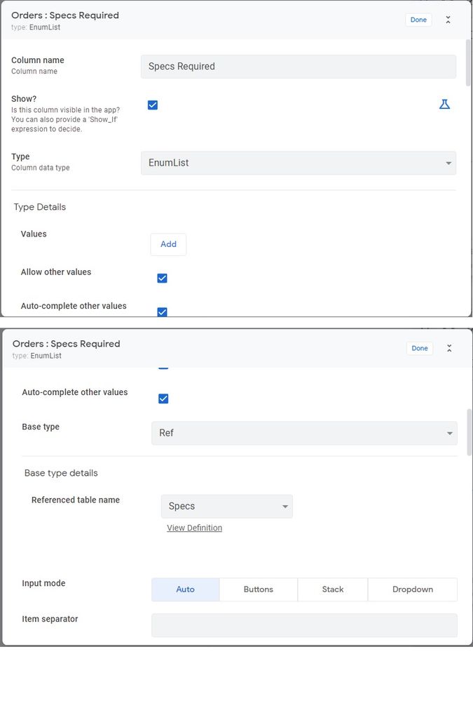

Please double check that you actually do have the base type set as Ref for your EnumList, and that you have selected the correct table, in the column definition.
Yeah, thatโ€™s the error I made as mentioned in my last post but it didnโ€™t solve the problem. For clarity I will post below an image of the gdoc that I am using, with most of the fields removed, it that helps. Maybe I am doing something glaringly wrong and Iโ€™m just too tired to see it.

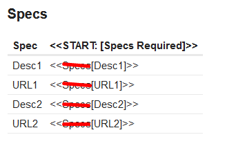

Again, remove the table name from your column references:
Ok, so here is what I changed it to
Spec <<START: [Specs Required]>>
Desc1 <<[Desc1]>>
URL1 <<[URL1]>>
Desc2 <<[Desc2]>>
URL2 <<[URL2]>>
Desc3 <<[Desc3]>>
URL3 <<[URL3]>>
Desc4 <<[Desc4]>>
URL4 <<[URL4]>><>
And this is what the Specs Required field is set up as
I then tried running it but it comes up with the following errors:
Expression โ€˜[Desc1]โ€™ is invalid due to: Unable to find column โ€˜Desc1โ€™, did you mean โ€˜Tab1โ€™?. Error: Workflow rule โ€˜Email JSA Specs Under Developmentโ€™ action โ€˜Email Specs under developmentโ€™ Body template. Expression โ€˜[URL1]โ€™ is invalid due to: Unable to find column โ€˜URL1โ€™, did you mean โ€˜Tab1โ€™?. โ€ฆ
The field itโ€™s suggesting, Tab1, is from the Orders table, whereas Desc1, URL1 etc are from the Specs table. How do I code it so that it tries to find the data in the Specs table?
Within a <<Start>>/<<End>> pair, column references (e.g., <<[Desc1]>>) refer to the rows identified in the <<Start>> tag. In your case, the <<Start>> tag is <<Start: [Specs Required]>>. [Specs Required] refers to a column of type EnumList of Ref to the Specs table. <<[Desc1]>>, then, refers to the Desc1 column value of a row of the Specs table. Expression Assistant is telling you the Specs table has no column named Desc1.
Thanks Steve, thatโ€™s what I thought may be happening. So does that mean I cannot achieve what I need to, or is there another way?
