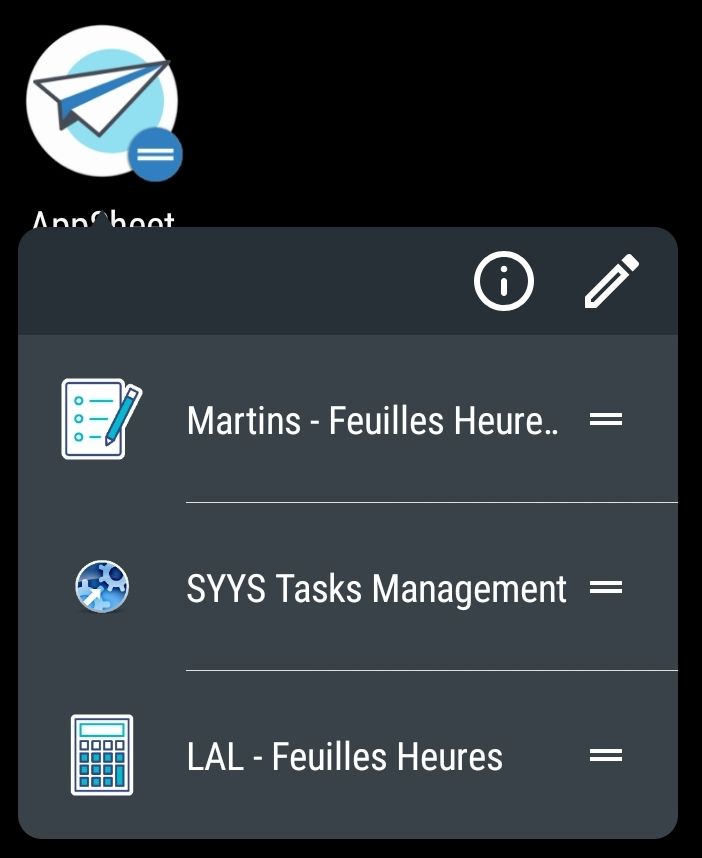

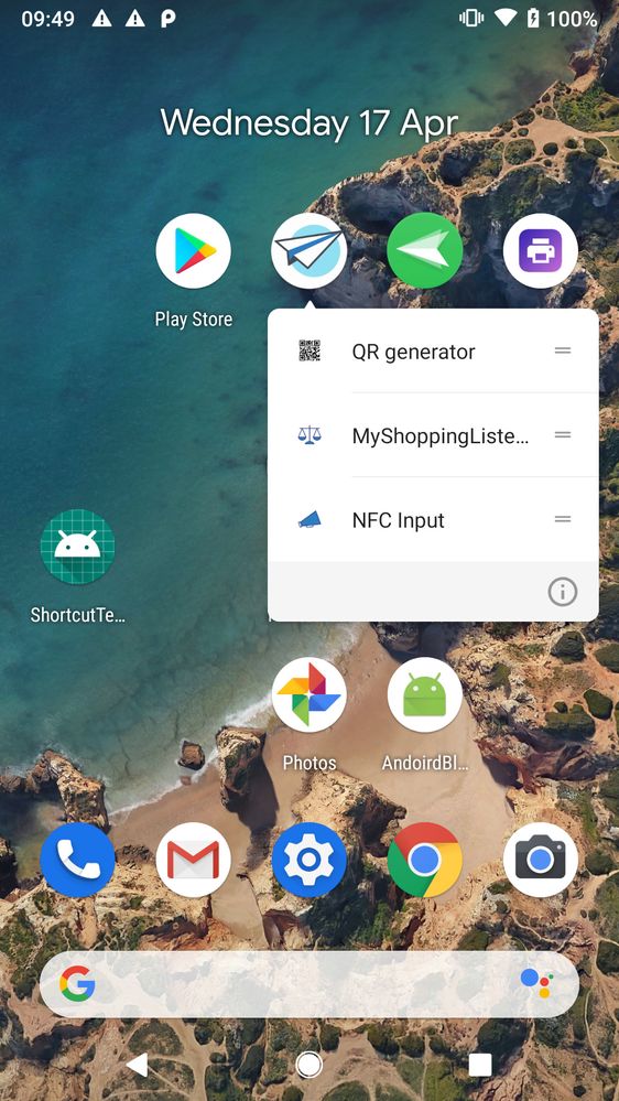

What I meant earlier is: if you go to your phone’s homescreen and press and hold the AppSheet’s app (with the paper plane logo) you should see shortcut to recently opened apps, see attached screenshots.
Hi Gil,
Attached is the printscreen of the recently open apps shown on my phone, this is right after using the app with the issue on the video.
The app does not appear there.

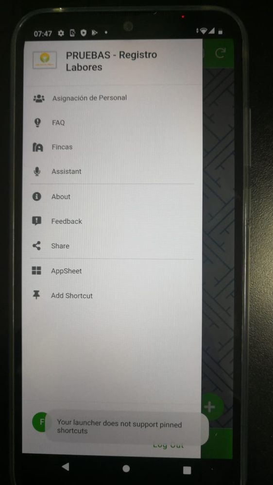

Hello, I have the problem but regardless of the icon, I do not believe it, my cell phone is a Moto E6i. it gives me this error.
That is a problem with your phone, not AppSheet.
I am currently having the same problem. You can put some icons and others give me that error.
Just in case you were able to solve?
It will be for the Android version or exclusively the phone model.
If you have installed an alternate launcher, the problem is with that. If you don’t know what a launcher is, you probably haven’t installed one.
My next guess would be a problem with some software your carrier installed. In the US, the carrier might be AT&T, Verizon, or the like.
It could be software installed by the phone manufacturer. Some manufacturers, like Samsung, replace key components of Android with their own alternatives. I have no experience with Motorola, so I can’t say whether they do.
I would suggest you look for help from the company you got the phone from.
