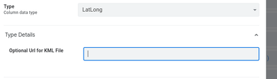

I have used multiple and different KML link references, but the only way I can see to get it to work is to edit the data source and select LatLong, select the field then fill this out at the TABLE level:
This is a single KML URL that applies for ALL records in the table.  This makes sense if I want to have a single base KML layer for my latlon points, but I can't seem to get a KML per record.

Thanks, but unfortunately, I think the answer from the link you provided (and of which I've previously read) is that NO, you CANNOT have a dynamic KML layer that is per record, nor can you specify a KML within the data itself.  Rather, it is a static + global URL that is metadata at the data source itself inside AppSheet.
Exactly
