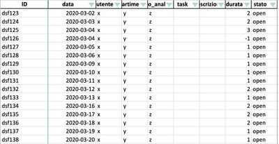

Hello to everyone,
I would represent this table in trend chart (col series or row series) showing the sum of column [durata] for each month and year.
I suppose that i have to create a Vc to aggregate data for each month and year because each row is a single day

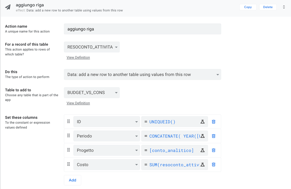

This field are originated with the action "aggiungo riga" in the bot:
I have a problem:
every time I add a row in the RESOCONTO_ATTIVTA table it creates a new row in the BUDGET_VS_CONS table instead i would mantein a row for each month and in the field [costo] i would the sum the filed RESCONTO_ATTIVITA[durata]

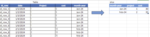

@WillowMobileSysin order to be more precise about the data,  on the left the table with data and on the rigt the slice that i would show in chart. As you can see, in the slice there is the sum of cost for each month (jan 2024 and feb 2024)
tks for your support!
