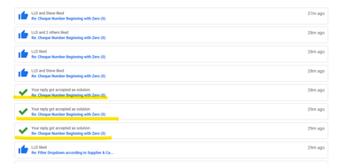

Hi @LLD ,
It sounds that you have marked all posts in this thread ( and possibly other thread of yours) as solution. Even though this post is old, I received multiple notifications just an hour ago as the image below shows.
My request to you will be to mark any one post in the post thread as final solution. Or else the number of solutions will be incorrectly showing on higher side. For example, this post thread shows as many as 8 total solutions , that will set an incorrect count for rightful solutions.
May I request you to do the needful in all your such posts to mark any one as solution. There are of course rare post threads where two or more totally different problems are solved in the same thread where one may mark more than one post as solution as occasional exceptions.
