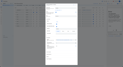

I trying to create an action that combines the values of two selected rows. In other words, when I multi-select two rows and press the Combine action, I would like the action to create a new row and sum the values in Column 1. Is this possible?
This is the expression I used:
CONCATENATE(SELECT(Untitled spreadsheet[Test 1], ([Test 1] = [_THISROW].[Test 1])))
I know I'm totally off with the expression but I'm not sure what to use. Thank you for any help.

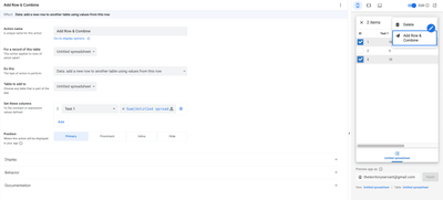

I have changed few things in the test app which you have shared. changes are listed below
1. You had hidden the edit action, but I have made it visible.
2. I have added the "Combine Column (Enum list)" to the quick edit columns. This allows you to add a list of rows to be combined from the detail view of a particular row/record.
3. A new action named "Set or Clear the Enum Columns to blank" has been created.
4. The new action type was set to "Set values to some columns of this row":
- Column "combine" was set to "" (blank).
5. A group action named "Add Row & Combine row and clear Enum column" was created.
6. The "Add Row & Combine" action was added as the first action, followed by "Set or Clear the Enum Columns to blank" as the second.
7. The following actions were hidden:
- "Add Row & Combine Set Values"
- "Set or Clear the Enum Columns to blank"
8. The group action "Add Row & Combine row and clear Enum column" was set to be prominent.
Now your need may be satisfied !!!. Welcome to appsheet community.

No issues with the Action which you have created. If the Test 1 column type is number then
in the Expression use this Test 1 = Sum(Table Name[Test 1]). Select Primary Position for this Action.

Thank you very much for your reply. The Expression is close to what I am looking for.
However, I added another row to test the process. The combine action is adding together all of the Test 1 column's rows (10 + 5 + 10 = 25). I only want the rows that are selected to be added together (10 + 10 = 20). I would also like to have just one new row, not new two rows.
thank you
Awesome Jaichith! This worked very well and it satisfied my needs. I truly appreciate the time to help me out with this process! Thank you sooo very much!
