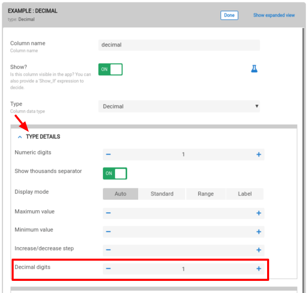

If the Decimal value is from a column, you can choose the number of digits after the decimal point in the column configuration:
