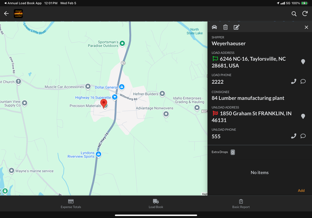

I tried this but I’m not able to make it work but
Im thinking that to start with if we can change the Origin and destination to match the Load data ID Start and stop pointsIMG_0628.jpeg
1. By using the Load data will be the first part of the script by setting the two points. Then Google maps would track state miles from that. But only launched from this table The ID has bot points that will be needed to track.
