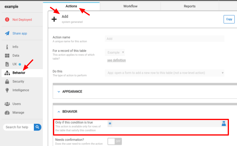

You’ll want to instead adjust the Only if this condition is true properties of the Delete and Edit actions for the table.
You are right, but the problem is that sistem generated actions will be reset to default every time I rebuild table structure … and it’s dangerous
