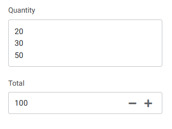

Convert list of numbers from LongText field to number
Help Appsheet experts, I'm trying to convert a list of numbers in the LongText field to a number, I tried using this formula EXTRACT("NUMBER", [Quantity]), the quantity field has a list of numbers on each line but it is in text format when trying to apply the formula it only converted the first number in the list but not the rest, any suggestions or contributions for this case I would be very grateful.

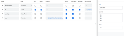

I would like to apply the expression EXTRACT("NUMBER", SUM([quantity])), in the Total formula, I am a newbie at this, these are my first experiences in Appsheet, excuse me, but my idea is to convert the sum of the Quantity field to the Total field, please if anyone has gone through this, give me a guide on how to solve it.
@KON_TROLL I tried to try like this, or is it another way sorry if I didn't do the right thing
โ€ƒWhen I save with the formula the Total field disappears from view
SUM(EXTRACTNUMBERS([cantidad]))

SUM(EXTRACTNUMBERS([cantidad]), just get the first one back. I would like you to do the sum which would be 110
I dunno. It worked for me.

Another way I was trying was to put the + sign after each number, it adds it up, but putting the operator for each number seems tedious to me
