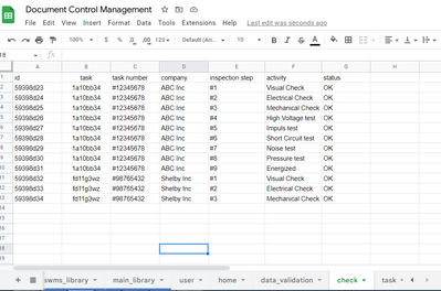

Hello guys,
I need your help to convert the data into .pdf format based on the same [task_number].
i have set up bot and automation, it works. But only converting to pdf row by row.
is there a way to group data into one .pdf document based on the same [task_number]?
Thank you very much for your help 
