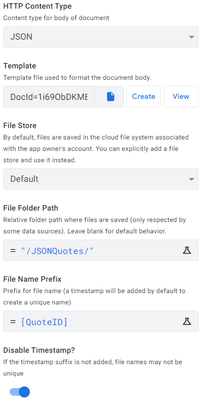

So, whenever Appsheet saves a file it places it in a folder within your App's working directory.  In my case the working directory is on a Shared Drive which is the recommended way of doing things in Google Workspace.
This is how my JSON creator bot is configured.  The first time this executes, it creates the JSONQuotes folder within the App Folder.  You can then open this folder and retrieve the FolderID from Google Drive.  Armed with this you can use something like the following to query the folder and get the file...

Thanks @scott192 .  I'm going to give this a try.  Definitely looks like it will solve my loop-thru-list problem.
