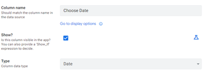

Alternatively, if you don't actually need the list of dates.  You could use the valid if section to constrain the users selections based on the start and end dates.
If you're trying to get someone to choose a date between your start and end.  Make a field of the type "Date"
The change the valid if to reference whether [_this] is between those dates and include an error message to communicate this accurately.
valid if:
and([_this]>=[Start Date],[_this]<=[End Date])
Invalid error:
"You must select a date between "&[Start Date]&" and "&[End Date]
The downside of this is, the date picker doesn't actually block out the dates that are invalid.  It waits to see what the user selects and then checks the validation when they try to progress.  But it's a slightly more built in solution if it fits your need then having to link in another table to reference the list of dates.
