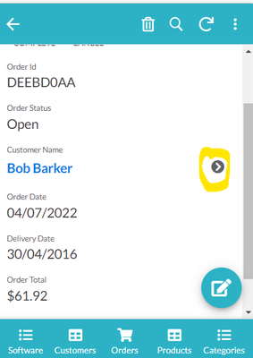

In that app, when the user adds a new order, the can select a customer name that is referenced from the Customers table. If the user wants to add a new customer, the user can use the add option shown with the dropdown.
Now in the sample app, the order form just references the customer name from the customer table. In your case you could use dereferencing to add other fields such as customer phone , address and so forth, once the customer name is selected. Please take a look at the dereferencing expressions article that I have mentioned. Instead of dereferencing, another option is the user can simply tap on the customer name to navigate to that customer's more details.

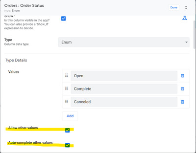

Maybe you wish to consider the options of Allow other values and Auto complete other values options.
Drop-down from simple list of values - AppSheet Help
Thanks Suvrutt, but that does not capture the data in a separate table. The customer's details(Name, Email, Cellphone, address, etc) get used and referenced by various other tables and slices so the data needs to be in a table and not in an enum virtual list.
