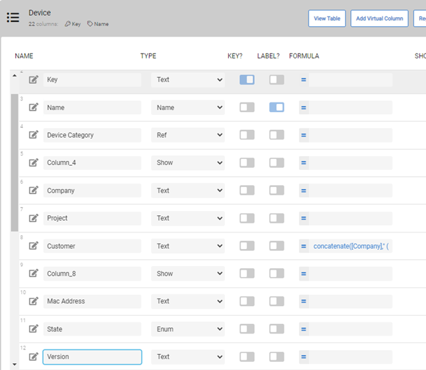

The table:
And some sample data:

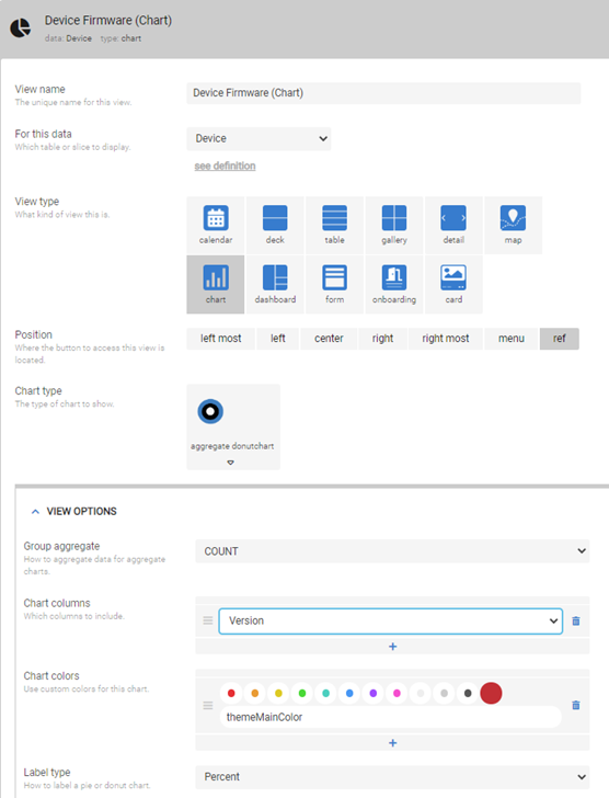

My Dashboard View is simply two view:
Customer List
Firmware
โ€œCustomer Listโ€ is based of from โ€œUnique Customer (Slice)โ€ and just shows the customer column in a table view
โ€œFirmwareโ€ is a chart view based on the Device table. It is an aggregated donut chart on Version

Thank you very much. I may be missing some point but Version column is not in the sample data. Could you add it?
Also could you share how "Firmware Chart"is constructed. There is Device category column. Does one customer have only one device (category) and associated versions ?
Looks like the image is cropped when I paste so I have created some new data and will attempt to paste again
Here is the Chart view:
Each Device only has one Customer, one Device Category and one Version
