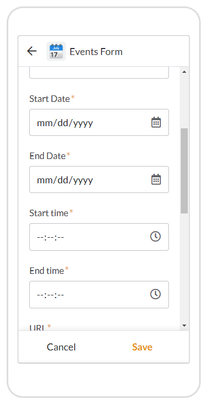

This is the screen when I select the + everything is blank and when I open to edit it shows the time of when I make the entry (TIMENOW)
When I chose the +When I chose the +

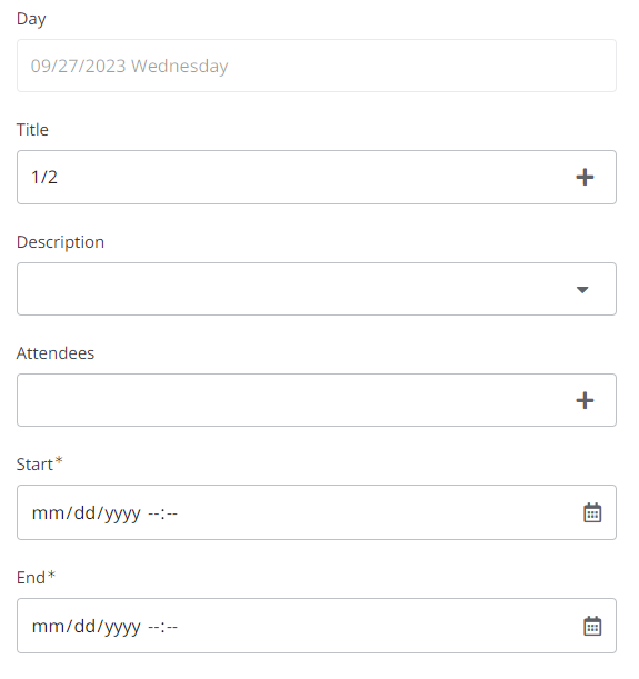

After I click on the event prior to editing it
when i click to edit the same eventwhen i click to edit the same event
This is where I see the problem. The dates and time are not appearing in the window and when I select the date picker or time picker it defaults to the current time and not the original time. Unfortunately I cannot figure out how to take a screen shot to show this as the date picker drops off when I select the snipping tool.
the event that I added  does not show the data and timethe event that I added does not show the data and time
