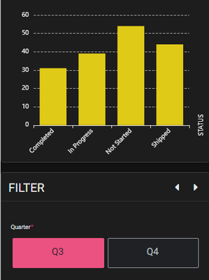

In the UX tab, it currently looks like this:
I created a REF Chart View of the Status
I put in the REF Filter View as well
however whenever i choose any of the quarters the chart does not follow :(((

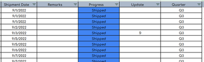

This is a sample of my Buildplan table
Hope you can help with this too

For this approach to work, it requires 2 tables, a Slice and two Views:
1) A Filter table to specify HOW to filter the data rows.  This could be just a single column single row table.
2)  A data table to be filtered.
3)  A Slice that applies the Filter input to the data table to get the filtered rows.
4) The Filter view set to show the single table row.
5)  The data View (in your case a Chart) that uses the Slice to determine the rows to display.
The idea is this...when you change the Filter in the Filter view, the Filter table row is updated.  The Slice will automatically adjust based on the new selection.  With the data view using the Slice as the datasource, it too will automatically adjust when the filtered rows change.
Follow the example app, plugging in your bits where different and you'll get exactly the results you want.
