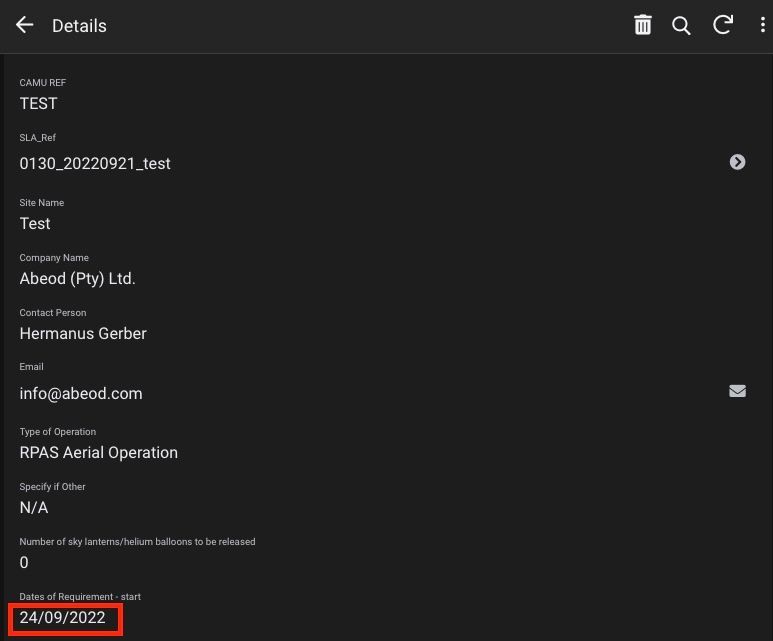

When I fill out the form the date format is YYYY/MM/DD, but after the form is saved it is shown as DD/MM/YYYY:Screenshot 2022-09-24 at 10.15.07.jpgScreenshot 2022-09-24 at 10.19.02.jpg
The Date Format Displayed on the Mobile App will be according to the Languange Setting Selected on the device. For e.g. below setting will display Date in DD/MM/YYYY

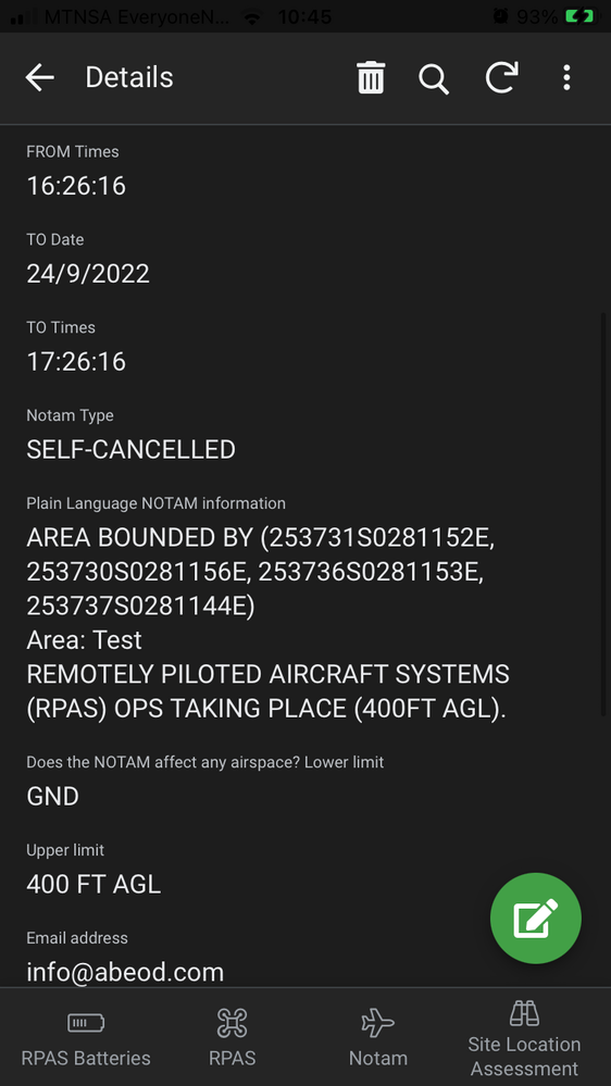

Also, the date format on my iPhone is YYYY/MM/DD, but in the Appsheet app (iOS) the date is still displayed as DD/M/YYYY:
