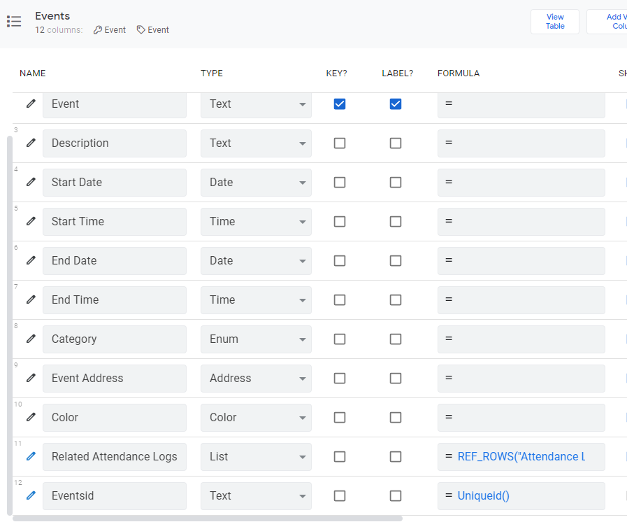

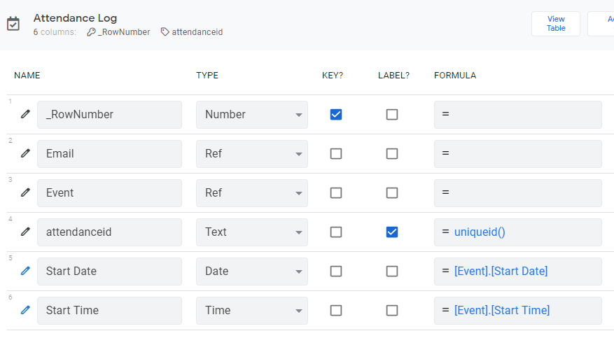

I am trying to accomplish a similar process. I have three main tables: Attendees Table, Event Table and Attendance Log table. The goal is to have a list of events that users can choose that they want to sign up for or drop themselves from the event.
The attendance log table has references to the attendees table and event table and looks like this:
The event table looks like this:
I have created an attend event action that does the following:
When I tried implementing the suggestion of
FILTER(
โ€œTable Bโ€,
([_THISROW].[PermitNum] = [PermitNum])
It deleted all of the attendance log. Any suggestions on what I can do to implement this drop event action?

This expression still dropped all of the attendance log. I feel like I need to have some unique identifier that concatenates User + Eventsid for the expression to know to look at a specific eventsid for a specific user. Right now it seems to drop all of them because the eventsid matches everytime between the event table and the attendance log table, because it is a reference column and therefore will always match.
This Drop Action is presumably being triggered from the particular Event record?
I think use this as your referenced rows expression:
SELECT(
[Related Attendance Logs][_RowNumber] ,
[Email] = USEREMAIL()
By the way, I, and many others, would highly recommend setting up a Key column populated by Initial value of UNIQUEID(), instead of using _RowNumber as a Tableโ€™s Key.
Thanks for the suggestion on the referenced rows expression, I believe that worked. I also appreciate the advice on the key column, however when I switch the key to my attendanceid column which has the uniqueid() expression I get this message:
Should I have a formula in the google sheet in that column that has uniqueid?
Thanks,
Initial value, not app formula
Got it, thank you for the clarification! Really appreciate your help in figuring this out.

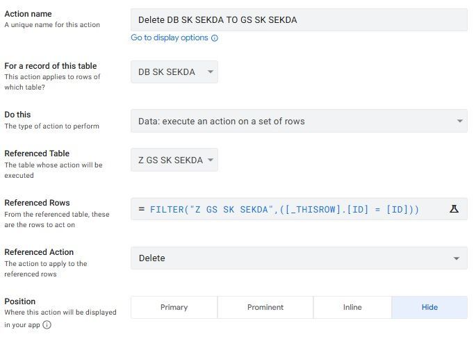

I have the same problem
However, when I press the delete button for several tables, it only deletes the first action, the next action is not carried out.
this for Primary action
Action buttonAction button
first action order
second order
last action order
"The ordered list of actions to execute" only first action,
even though the action is moved to another position, only the action in the first position is still carried out
help me, please...
The row from/on which the action is invoked must exist throughout the entirety of the action's run. If the action itself (or another action invoked by this one) deletes the row, all further processing stops.
