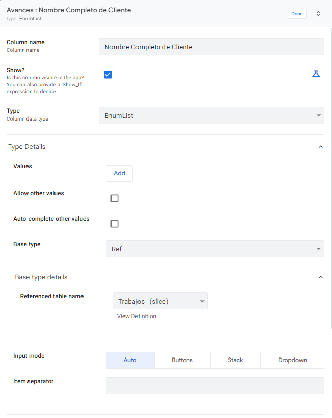

In the second table, you can create a column type EnumList, base type Ref, and point it to the first table.

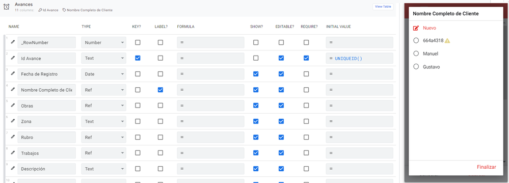

Hello seddik Good Day, I tell you that I tried what you suggest, however it failed. In the first table, the names are already a reference to another. I choose the names of the clients based on a third table. Perhaps the "EnumList" does not work because it is about referencing with a table that is not the owner of the data (so to speak).
Can you please show us the columns of your table? Thank you.
Here I detail the Enum List type column configuration, based on Ref type, indicating the first table. In the first table I already have a series of data loaded that should show them.
As you can see. In the first table I load the data that is referenced to other tables. Once I have loaded all the data, this data must be available in a second table in a drop-down manner.

OK.
The column of type or base type Ref provides a reference to the KEY column of the target table. Therefore, the only way to reference the table "Trabajos" from another table is to add a Ref column in that other table that contains values of the "id Trabajos", not "nombre de cliente" or any other column; because "id Trabajos" is your key column.
However, it is still possible to show los "Nombre Completo de Cliente", as I understand is your goal, by just marking this column as a Label
Your dropdown list will actually contain values of the Key column: "id Trabajos", but what you will see displayed instead are the corresponding values of the Label column "Nombre completo de cliente".
If this doesn't solve your problem, please explain more what do you mean by "does not work". Thanks.

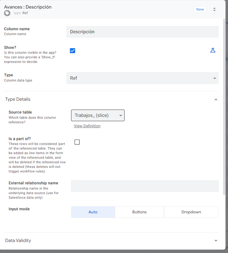

Ok Seddik, I'm almost solving the problem.
I have managed to create a forecast table and a progress log table. Both are practically twins, the only difference is that the second one (the advance table), only allows records that are as planned. The charging process is done in a chain. Everything goes well, except for a yellow exclamation mark that appears in a field when choosing.
Do you know what could be causing this?
The triangle indicates a broken reference and I see two reasons for you to get it:
  1. You can only reference the key column in the target table, so unless "Descripciรณn" is the key column in your "Trabajos" table, which I highly doubt, referencing will not work. To construct the reference, the value of "Descripciรณn" column in "Avances" will be looked for among the the values of the key column in "Trabajos", not any other column.
  2. Ref column should have a single text value, since they key column in the target table will always be a single text value. However, your app formula will return a list, even if it contains a single item, it will be a list. Therefore, when you use commands that returns a list (like SELECT) to get a single value, you should also convert it using for example ANY().
Also, I was going to tell you that you should not be having two tables of identical column structure because one table is a subset from the other in term of rows. Instead you should use a slice.
May be I'm wrong, but from your captures it seems that you are using a slice for that purpose. If this is the case, then you do not need to do any referencing between the table and its own slice.
