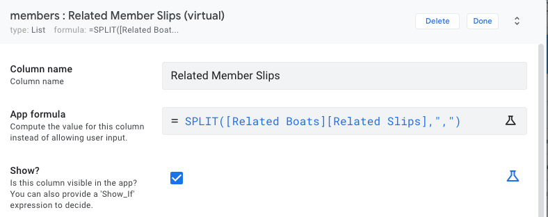

The new column:

Thank you. It sounds that there is a space in the separator such as  " , ".
If so could you try as recommended without space, that is ","
SPLIT([Related Boats][Related Slips],",")
There are no spaces, it just looks that way.
Okay, thank you. Could you please try
SPLIT(TEXT([Related Boats][Related Slips])," , ")
Okay, so with that change, the column now shows "related member slips(1)" in rows where I'm expecting one or more slip names to show.  When I change the column to a base type of text, it shows me the index field value for the slip.  So, that's closer.
