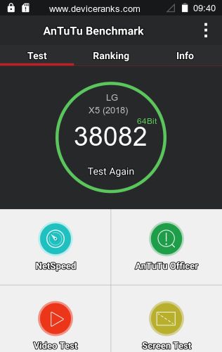

Thank you very much, @praveen and @1minManager ! Iโ€™m starting to think that my Android device might be the problem. With 8,000 records, my app works quite nicely on iPhones (even an old iPhone 6) but can be sluggish on my LG X5 (2018), which doesnโ€™t have very high performance ratings:

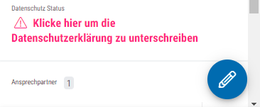

Another use case: Instead of showing the Action, use a Show Type VC and attach the Action to it.
This is possible with Text Column type, but not with Show column type.
