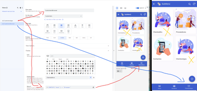

I have these two views, it's the same table of course, only the idea is that the app only shows 3 fields, and the broser shows all the fields

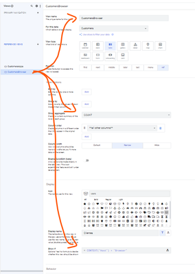

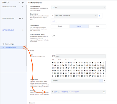

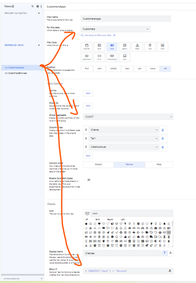

Customers table first View "CustomersApps" type table, column order (3 fields) Show if = CONTEXT("Host") = "Device"
Customers table second View "CustomersBrowser" table type, Column order (all) Show if= CONTEXT("Host") = "Browser"
However, both are shown both in the app and in the browser, that is, it does not work

When you have a gallery view, the items displayed are not VIEWS and therefore will not use the View Show_If property to determine visibility.  They are simply rows from whatever table you are using as the source.  Your rows may correlate to some view meta data such that when the gallery item is clicked your are redirecting the user to a specific view through an action.  In this situation, you would need to use a different mechanism to show/hide the gallery items based on Host context.  I said to use Show_if in the column which was wrong.  Instead you would need to filter the rows with a Slice and use that Slice as the data

The parameter passed IS case-sensative, I believe.  Try using "Host" and not "HOST".

I could see why it doesn't work, this parameter doesn't work for Ref positions, and the views of my menus are as icons in the REF position
See that the views with the positions in REF do not work, they are the ones that are marked with a yellow X, however the others themselves work

Hi Peterson, it does work, but it only works for views that are PRIMARY NAVIGATION or MENU NAVIGATION, but for REFERENCE VIEWS, which are the ones I use, as well as the images in the center of the screen, it doesn't work there
It should be the same and work, but it doesn't
In the previous photo there are two devices, a browser and smartphone, in both it works only if the view is in PRIMARY NAVIGATION or MENU NAVIGATION, but if you see the photos there are some X marks, it does not work there since they are referenced views
The Submenu view you're showing that has the Yellow X's, how is it defined??
Because to me it looks it is a Gallery View of which there are row items labeled as "ClientesBrowser" and "ClientesApp".  If that is the case then these row items are NOT filtered by the Show If constraint on the views.  They can be filtered by using the Show If property on the proper column of the Table your Gallery View is based on.
