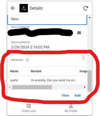

Firstly, I have an apps which User can raise ticket if they have any issues.
Let's say in above image, me as an "Admin" add any comment/value inside "Interaction" area. How do i want only "Anatoliy" which is the one who issue the ticket receive the Push Notifications?
Same as admin, if "Anatoliy" put any comment/value inside "Interaction" area, how do i want only the one with "Admin" role can get Push Notification.

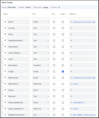

Above image is "Interaction" table which is Ref to "Ticket" table using Ticket ID column.
Above image is Ticket table.
How do I want to create the expressions in Bot? What type of expressions should I use?

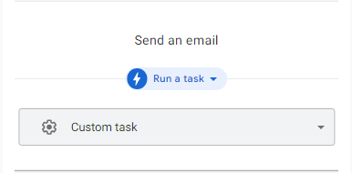

To receive push notifications, if 1 user have 1 email to use the appsheet, then you can use the email as the recipient in the process of the bot by running a task.
However if your users are sharing the same email it might be a bit hard since the notifications can only use email unless you ask for their private mail address and put that column inside the To functions of the bot.

For my system, no email sharing is allowed. Only 1 user for 1 email.
And as of now, I already have an email bot which send notifications and email to admins if the user issue a ticket.
But now i try to be specific, which only the ticket issuer can received notification if admin commented in the "interactions".
So the issue i have now is how do i create to expression so that when admin commented in the "interaction", a notification will send to the ticket issuer.
