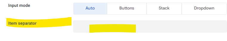

Hi @Rory_Forde
You can go there:
And in the base type Details Section:
Go to “Item separator”, and set your comma, dot, or any separator you are facing:

Wow… if that works I will need to buy someone a beer…
One question - do I need to add the values to the ENUMLIST manually - its not a problem just wondering…
RoryF
Normally not with this option
I will try that.

All of that worked…
And as an added bonus is looks like the issue with the CR/LF is a non-issue - Appsheet picked up both lines (maybe it sees the value as a single entry and just includes the CR/LF in the record).
Sooo happy - you saved me so much time…
Roryf
