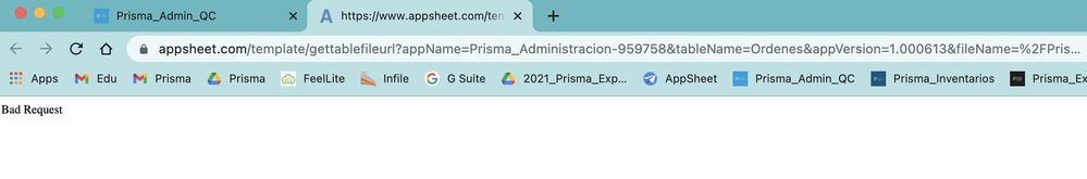

Then I execute this action,
and then, this is the error I get,
I don’t know what might be causing that error. But here are some things to look at:

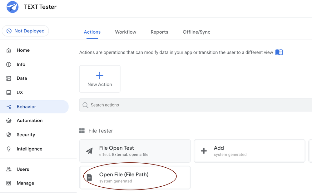

  1. When you create File column, the system automatically creates an Open File action so you don’t need to create your own. It may be hidden. You would need to “Show System Actions” by tapping the button at the very bottom of the Actions list.
System ACtion to Open File
In Table and Detail views, the system Open File action is automatically shown as indicated in the images below
