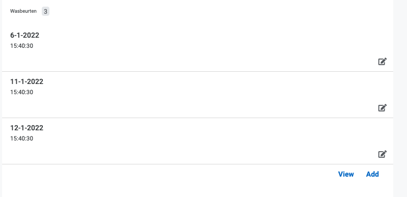

Is there an option for showing a reference column in descending order?
First 12-1-2021 then 11-1-2022, …
And is there an option to put the add next tot the name wasbeurten?
Thank you so mutch

Yes, you do this is the view definition. What you are showing is an Inline view. It is a system generated view. To see it, you will need to go the UX tab in the Editor, scroll to the bottom and tap the “Show system views” button.
You could then just scroll through the views, they are sorted by datasource the view is based on, until you find the view. But the easiest way is in the app emulator, tap that “View” button under the inline table. This will take you to a full screen view in the emulator. Then under the emulator is a View property that shows the name of the view AND is a link. Tap it and you will be taken to the view - NOTE: “Show system views” must be ON for the link to go to a system generated view.
In the view definition, once you get there, change the Sort order
Unfortunately, no.
