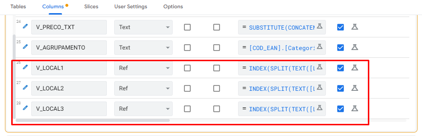

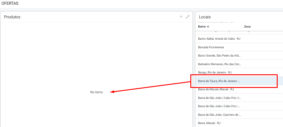

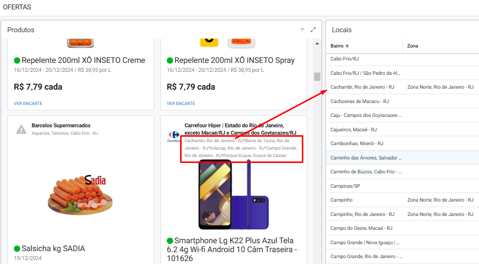

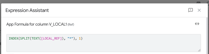

I have been experiencing a problem similar to yours. I even found a solution, but then encountered another issue that I couldn't solve. To make the filter actually work, I had to create some virtual columns that collect items from the list created in the enumlist, setting my virtual fields like this: INDEX(SPLIT(TEXT([LOCAL_REF]), "*"), 1) --> in this virtual column, I splitted the items by asteristic ("*"), looking for item position at list in LOCAL_REF, and then repeat the formula for other virtual columns, changing it to 2, 3, 4, and so on. After creating the virtual fields, I change their type to Ref and reference my LOCAL table. Visually, the references appear when I access the view and navigate, however, when I create my Dashboard and click on a specific LOCAL_ID, the filtering only works for virtual 1, the others are ignored. See the images below to better understand what I'm talking about. I believe that if AppSheet can handle filtering for more than one REF, it should work.
