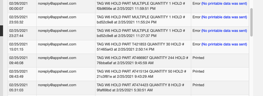

All, I’ve been sending a PDF to an email address xxxxx@print.epsonconnect.com reliably for over a year. Suddenly on February 25th the service stopped accepting the attachments to print. I have secure pdf turned off. I am able to download the email attachment. Resave the file using pdfviewer and then send a new email to xxxxx@print.epsonconnect.com and the attachment prints. I’m asking if this is something on AppSheet’s end or if anyone is having the same issue.

We found the reason. If you open any PDF file with Notepad, you will see that it starts with “%PDF-1.5”. And that’s how it has to be.The PDF files generated with AppSheet start with “òÁ%PDF-1.5” or “ª¶%PDF-1.5” or any other strange characters.That’s the reason why it’s not printable.
Since AppSheet changed from PDF Version 1.4 to 1.5, every PDF from every App has these strange characters.
Please open a PDF produced by AppSheet in Notepad (not in Acrobat).
It looks like this:
The characters before “&PDF-1.5” are the reason why the PDF is not printable i.e. Email Print like Epson Connect, or direct print via a Windows Service.
I can delete these characters in Notepad and save the file.
Now the PDF is printable.
