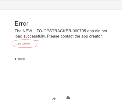

Error - Parse Error
I have an error however I do not see anything in red to help me figure out why there is an error.  I have checked ALL my tables.

I did NOT mean to check on that this is a solution.  I apologize.  I wanted to answer your questions:
  • So, what were the circumstances before the error started occurring?
    • New app - never deployed
  • Had you just made a change to the app?
    • newly built - so yes
  • Did you check the log file for noted error entries there?
    • no
  • Did you try clearing cache?
    • yes - this did not fix it
  • Can this app run on any other devices
    • no - it cannot run anywhere

Ok.  So I went through your steps.  I found the problem.  I had a reference to a column from another table that didn't exist.  however, it wasn't red?  Meaning, every time I have an error in Appsheet it will highlight the error in red.  not sure why it didn't.
I am not sure what you mean - maybe the term "reference" is ambiguous.  Maybe you mean you were accessing a column from another table?  If so, then it might depend on the context as to whether there would be an error or not.
For example, in views where we specify the columns explicitly, if we change the name of a column or remove that column, the view will still have it listed but simply ignore it.  It won't be highlighted as an error.  I have never understood why that is.
Anyway, glad you figured it out!
Yeah - that is what it was.  thanks for the help.  AGAIN!
