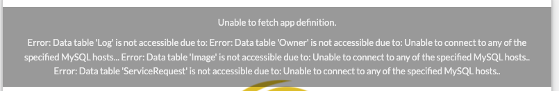

SkrOYC_0-1681396412512.pngI was executing some loops in an app I'm developing and it synced around 5-10 changes before it throws the error, then I manually sync again and the same...
Now, my error is a little bit different and I though it was related to my datasource but here it is in case it's related
