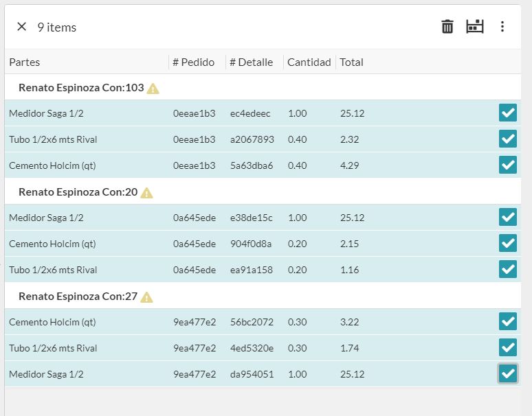

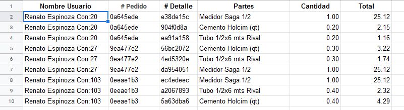

The table that has the items to be deducted:
The APP screen when I select the items to be subtracted:

Beginning inventory โ€œTubo 1/2โ€ฆโ€ is 19.3
Subtracting Qty of 3 from the orders = 0.2+0.3+0.4 = 0.9
Final Inventory should be = 19.3 - 0.9 = 18.4
But it shows final inventory of = 18.7
This shows that the decimal subtraction is wrong.

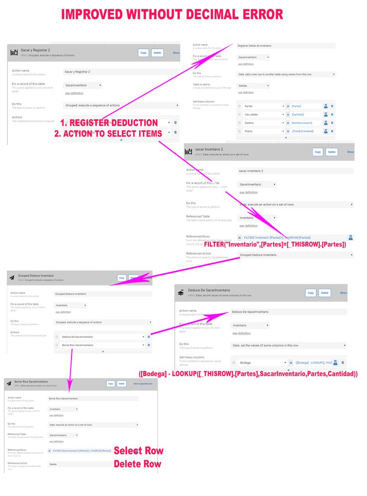

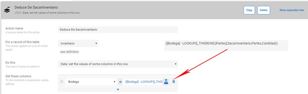

THE ACTIONS:
The multiple action that records the transaction and then substracts the items:
The subtracting action:

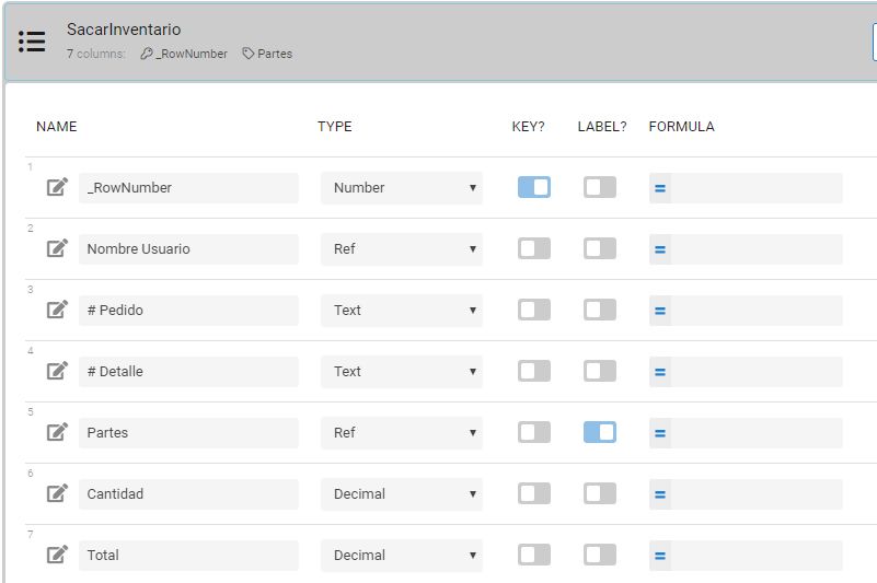

In your table images i do not see a column by the name = โ€œItemโ€. Were the names changed for the purpose of the post? If so, could you post the ATUAL formula you are using. It is important to know what column you are using to do the LOOKUP().
Yes, the table is in spanish.
Item = Partes
Quantity = Cantidad.
OnHand = Bodega

Table to subtract from inventory:
The table to subtract has the Item as ref to the Inventory table.

([OnHand] - LOOKUP([_THISROW].[Item],SalesTable,Item,Quantity))

I found a solutionโ€ฆ It seems the Lookup() function was doing a great job but the table records where not being deleted in time, or deleted in the manner that I thought the software was executing, so it garbed the wrong value. Now I have implemented a different execution where the row that was processed is surely deleted before the next row is processed. But if I have too many records of multiple clients to process the system seems to fail at some point.
I will try to do a flow chart to present the alternative execution.
The original actions shows below:
Improved actions where thee delete row function has been moved so that the processed row is deleted before the next row is processed.
The proposed solution only works when there are no multiple items with different quantities. For some reason the App still fails to subtract the correct quantities.
