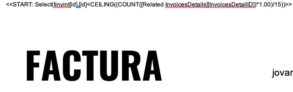

Have not done changes to the app and am getting the following error message when generating a PDF:
Error encountered in step with name [Print invoice]: Error: 'New process 7' task 'Print Inovice'
Body template. Expression '<u+200f><u+200f>CEILING((COUNT([Related InvoicesDetails][InvoicesDetailID])*1.00)/15)<u+200f><u+200f>' is invalid due to: Unable to find function '<u+200f><u+200f>CEILING',
did you mean 'CEILING'?. Error: 'New process 7' task 'Print Inovice' Body template.
Expression '(CEILING((<u+200f><u+200f>COUNT([Related InvoicesDetails][InvoicesDetailID])*1.00)/15)=
([id]+1))<u+200f><u+200f>' is invalid due to: Unable to find function '<u+200f><u+200f>COUNT', did you mean 'COUNT'?.
Error: 'New process 7' task 'Print Inovice' Body template. 'If' expression
'(CEILING((<u+200f><u+200f>COUNT([Related InvoicesDetails][InvoicesDetailID])*1.00)/15)=([id]+1))<u+200f><u+200f>' yields
 a result of type '' rather than the expected type 'Yes/No'. Error: 'New process 7'
task 'Print Inovice' Body template. Expression '<u+200f><u+200f>COUNT([Related InvoicesDetails]
[InvoicesDetailID])' is invalid due to: Unable to find function '<u+200f><u+200f>COUNT',
did you mean 'COUNT'?. Error: 'New process 7' task 'Print Inovice'
Body templ
 nbsp;encountered in step with name [Print invoice]: Error: 'New process 7' task 'Print Inovice' Body template. Expression '<u+200f><u+200f>

What are you using as a template?
a Word document.
Try unstyling all of your Start: expressions
Inovice' Body template. Expression 'START: TOP([Related InvoicesDetails]
[InvoicesDetailID],[id]*15+15)- TOP([Related InvoicesDetails][InvoicesDetailID],[id]*15)'
 is invalid due to: Unable to find function 'START: TOP', did you mean 'STARTSWITH'?.
Error: 'New process 7' task 'Print Inovice' Body template. Expression '[Order Name]' is
invalid due to: Unable to find column 'Order Name', did you mean 'FileName'?. Error: 'New
process 7' task 'Print Inovice' Body template. Expression '[OrderID].[Dias entregados]'
is invalid due to: Unable to find column 'OrderID', did you mean 'Created'?. Error: 'New
process 7' task 'Print Inovice' Body template. Expression '[OrderID].[Fechas Entregadas]
' is invalid due to: Unable to find column 'OrderID', did you mean 'Created'?. Error:
'New process 7' task 'Print Inovice' Body template. Expression '[Quantity]'
is invalid due to: Unable to find column 'Quantity', did yo
I did change then and got the above error.
Can you make sure there is no blankspace between Start: and TOP?
Start:TOP # This
Start: TOP # This not
Just trying, I don't recall if it should work with a blankspace or not. The rest "Unable to find.." stuff is related to the Start: not being recognized
Still does not work, it gives error.
Error encountered in step with name [Print invoice]: Error: 'New process 7' task 'Print Inovice' Body template. Expression 'START: TOP([Related InvoicesDetails][InvoicesDetailID],[id]*15+15)- TOP([Related InvoicesDetails][InvoicesDetailID],[id]*15)' is invalid due to: Unable to find function 'START: TOP', did you mean 'STARTSWITH'?. Error: 'New process 7' task 'Print Inovice' Body template. Expression '[Order Name]' is invalid due to: Unable to find column 'Order Name', did you mean 'FileName'?. Error: 'New process 7' task 'Print Inovice' Body template. Expression '[OrderID].[Dias entregados]' is invalid due to: Unable to find column 'OrderID', did you mean 'Created'?. Error: 'New process 7' task 'Print Inovice' Body template. Expression '[OrderID].[Fechas Entregadas]' is invalid due to: Unable to find column 'OrderID', did you mean 'Created'?. Error: 'New process 7' task 'Print Inovice' Body template. Expression '[Quantity]' is invalid due to: Unable to find column 'Quantity', did yo
I think there is a problem with the way AppSheet parses the template, so please contact support
