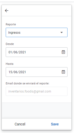

This is the form to generate the report:

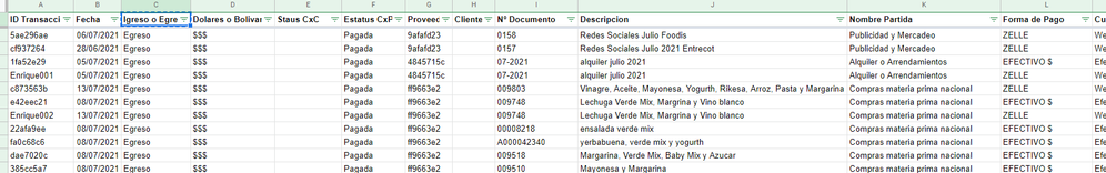

And this is how the table is organized where the data that I want to filter in my report is found:
