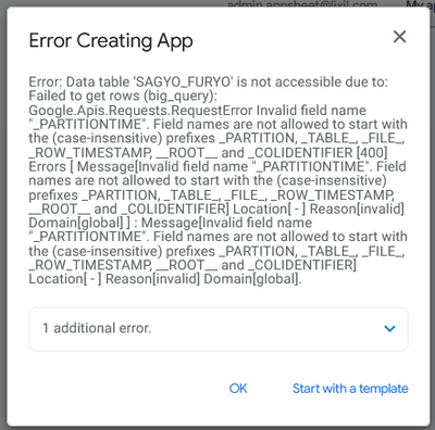

I am trying to create an app with BigQuery tables as the data source.
The following error occurred when I selected the target table and attempted to create an app.
Is it NG to include "_" in column names?
This table is a partitioned table with a pseudo column named "_PARTITIONTIME".
Is it possible to use partitioned tables as a data source?

I checked the following page and found that partitioned tables are not supported.
https://support.google.com/appsheet/answer/11905680?hl=en#:~:text=Partitioned%20tables%20are%20not%2...
A column name starting with "_" is OK for Big Query.
A column name starting with "_partition" is also OK.
A column name starting with "_PARTITION" is NOT OK.

When I create a partitioned table in BigQuery, it seems to create a pseudo column named "_PARTITIONTIME", can I use the partitioned table as a data source for AppSheet?

Okay ๐Ÿ™‚ I thought you were just suffering from the column name in general.
