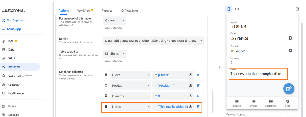

It is not exactly clear what problem you are facing while adding the text. Please elaborate. I request you to also take a look at the following post thread that also refers to a sample app. The app adds quantity through the action. Similarly you could try with the text. I added a text column “Notes” and added some text in that column through action and could do the needful.
Hi ,
Please take a look at the following action type in the article below , if it helps you.
Data: add a new row to another table by using values from this row

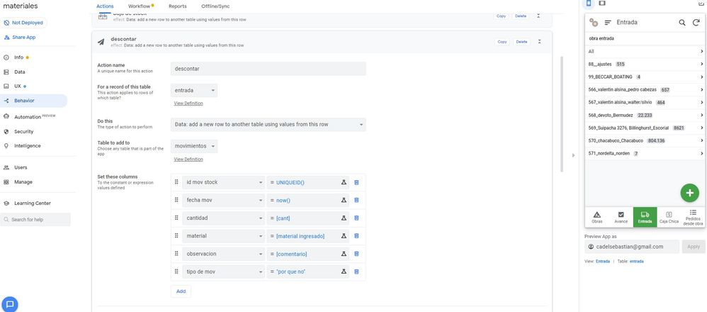

hola Muchas gracias . lo pude hacer!!!
funciona,
tengo una consulta mas
cuando le quiero agregar un registro a la tabla movimientos, me deja solo con valores de la tabla entrada
pero no me deja agregarle valores nuevos de tipo “texto”, como pueden observar en tipo de mov… cuando le pongo un valor tipo texto entre comillas, como muestra ahi… DIRECTAMENTE NO ME AGREGA EL REGISTRO EN LA TABLA, sera que no permite ingresos de tipo texto
