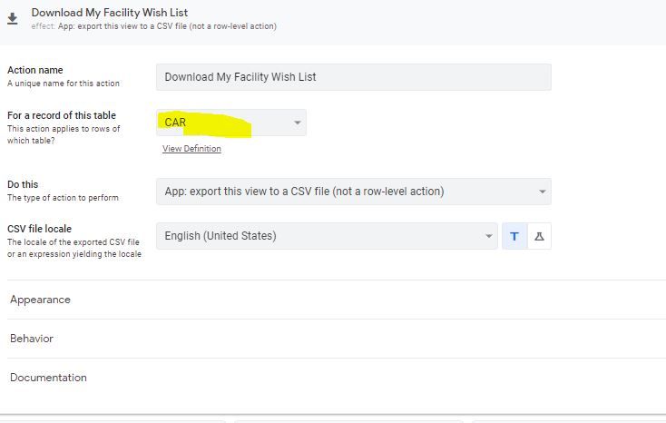

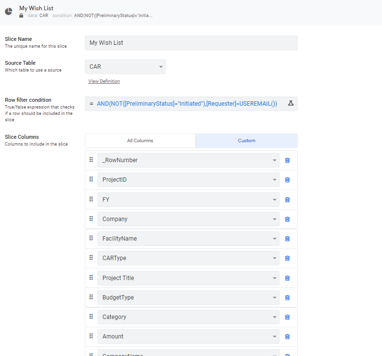

we have a view based on a slice. This view only shows the records I want to export to CSV. See the attachment for the view setup.
I have also included the action on that slice/view. It will download the whole CAR table, not just my view.

It seems like the download ignores the useremail() formula. We use it it in our slice but it is ignored on the download.

Could we get a screenshot of the My CAR Requests slice configuration?
so we have the action on a view of this slice
The view works perfect. but when we click the action everything in the CAR is exported not just the records that are seeing in the view obtained from this slice.
It all looks good to me (though thereโ€™s a lot to follow, and I might be overlooking something). As far as I can see, you should be getting your desired behavior. That youโ€™re not suggests a bug. A bug means youโ€™re going to have to engage Support. Someone there will be able to dive into your app configuration directly and figure out whatโ€™s going on.

I do have the a view that is based on a slice (so I am only seeing the records I want to export)
The action is displayed on that view.
When I click on the action the entire table is exported not the view I am looking at.
Here is the view setup and the action:
(CAR is the entire table)โ€ฆ
The action is on the view, but I can not change the โ€œrecord for this tableโ€ and it is exporting the whole table โ€œcarโ€
action:

I want to change CAR to be my view or slice.
