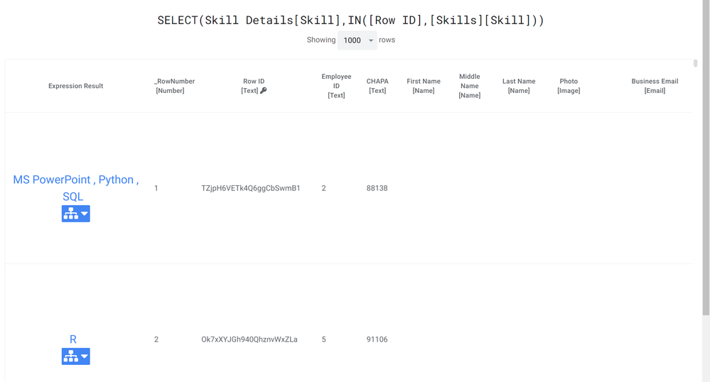

I have a virtual column with values computed through the following formula. Using the TEST feature, I was able to confirm that the expression result is what I need.
However, when I save this and load the table in the app, the values are DIFFERENT. Not only are the values not what I expect, every row has the same value.
I've tried this alternative formula: SELECT(Skill Details[Skill],IN([Row ID],[_THISROW].[Skills][Skill])), but the expression assistant threw an error at me: Error in expression '[_THISROW].[Skills][Skill]' : Unable to find column 'Skills][Skill'
Any idea how I can fix this?

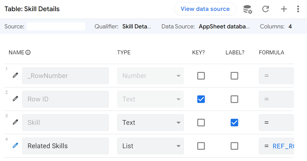

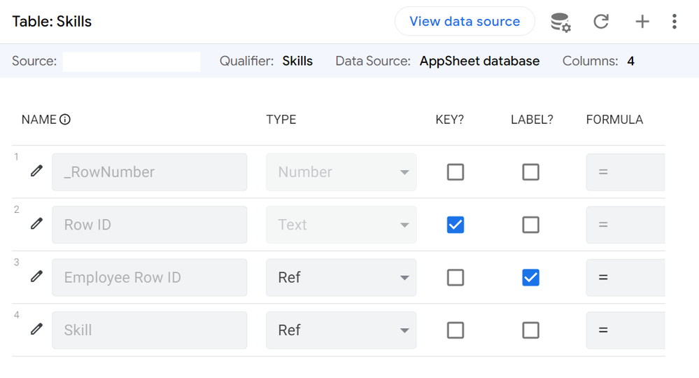

Would you please take a printscreen from your child table (from the editor), thanks.
The virtual column is in the Employee Profile table.
You will need an extra column for that
Thanks mate!
Added [Skill].[Skill] as a virtual column named _Skills in the Skills table.
Then I referenced that column in the Employee Profile using the formula: [Skills][_Skill]
