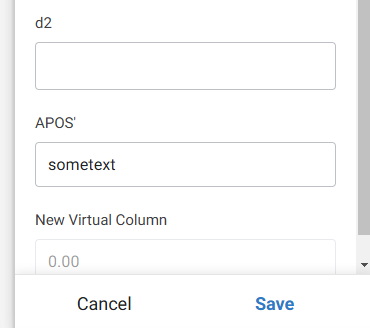

The following seems to work (..though it does not make much sense to me...)
  • Create a virtual column with an App Formula = "ATTIVITA'""'"
  • Use this column in your LINKTFORM expression like LINKTOFORM("***_Form", [this VC], <value expression>)
Note. I tried this using USERSETTINGS but did not work.
